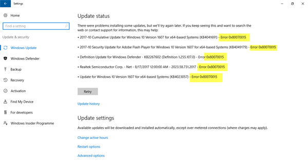

I am trying to update my Windows 10 version from 1803 to 1909.But I couldn’t able to I am keep getting windows 10 error one by one.
Please see the screenshot below:
f2cc0429-c2dd-4366-8ebd-094f9db140dd
I tried to update the PC using Windows 10 using Windows Media Tool with that also not luck.

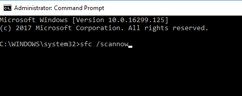

In some cases, a corrupted Windows installation can cause Windows Defender error 0x80070015 error to appear. However, you can fix this problem simply by performing an SFC scan. To do that, just follow these simple steps:
  1. Open Command Prompt as administrator.
  2. When Command Prompt starts, type sfc /scannow and press Enter .
    Error code 0x80070015 Windows 10 install
  3. The SFC scan will start. SFC scan can take about 15 minutes, so don’t interfere with it.
