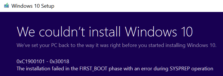

Installation failed in first boot for upgraded Windows 7 PCs
Due to Windows 7 end of life, we had to migrate all of our Windows 7 devices to Windows 10 in spite of a few hardware issues in some of the devices. We had a successful upgrade but all of a sudden this week about half of the Windows 7 to 10 upgrades devices have died and many are at completely different sites. All seem to rollback and leave the error message " The installation failed in the first boot phase with an error during Migrate Data operation. "
We have disabled windows firewall, uninstalled Antivirus, made sure all Windows updates are current, deleted the Windows_BT folder and nothing has worked.
What could be the problem here?

The installation failed in the FIRST_BOOT phase with the error during SYSPREP operation.

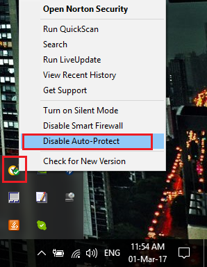

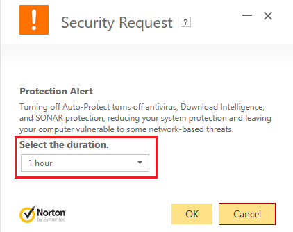

Method 1: Temporarily Disable Antivirus and Firewall
1.Right-click on the Antivirus Program icon from the system tray and select Disable.
Disable auto-protect to disable your Antivirus
2.Next, select the time frame for which the Antivirus will remain disabled.
select the duration until when the antivirus will be disabled
Note: Choose the smallest amount of time possible for example 15 minutes or 30 minutes.
3.Once done, again try to connect to the WiFi network and check if the error resolves or not.

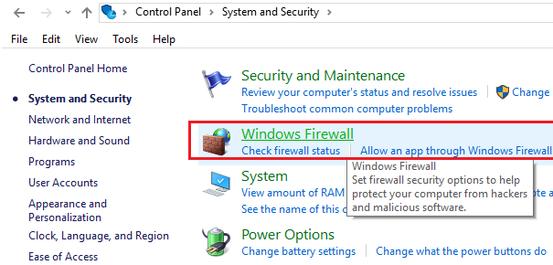

5.Next, click on System and Security.
6.Then click on Windows Firewall.

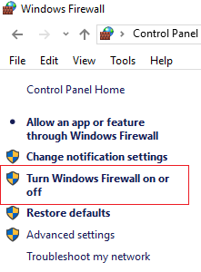

7.Now from the left window pane click on Turn Windows Firewall on or off.
click Turn Windows Firewall on or off
  1. Select Turn off Windows Firewall and restart your PC. Again try to open Google Chrome and see if you’re able to Fix The Installation Failed In The First Boot Phase Error.

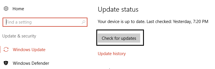

Method 2: Check for Windows Update

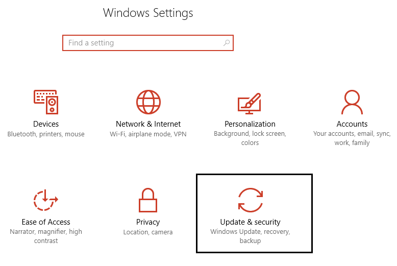

1.Press Windows Key + I then select Update & Security.
2.Next, again click Check for updates and make sure to install any pending updates.
3.After the updates are installed reboot your PC and see if you’re able to Fix The Installation Failed In The First Boot Phase Error.

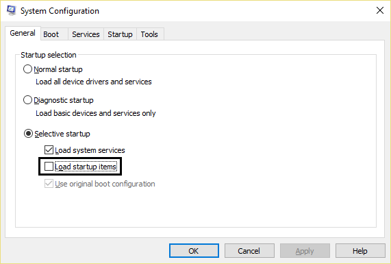

Method 4: Run Windows Update in Clean Boot
This would make sure that if any 3rd party application is conflicting with Windows update then you will be able to successfully install Windows Updates inside Clean Boot. Sometimes 3rd party software can conflict with Windows Update and therefore cause Windows Update to be Stuck. In order Fix The Installation Failed In The First Boot Phase Error , you need to perform a clean boot in your PC and diagnose the issue step by step.
Perform Clean boot in Windows. Selective startup in system configuration

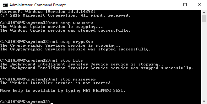

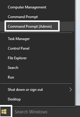

Method 6: Rename SoftwareDistribution Folder
1.Press Windows Key + X then select Command Prompt (Admin).
command prompt with admin rights
2.Now type the following commands to stop Windows Update Services and then hit Enter after each one:
net stop wuauserv
net stop cryptSvc
net stop bits
net stop msiserver
Stop Windows update services wuauserv cryptSvc bits msiserver

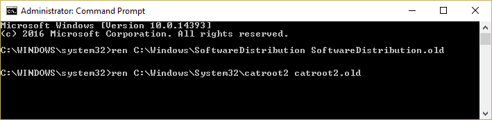

3.Next, type the following command to rename SoftwareDistribution Folder and then hit Enter:
ren C:\Windows\SoftwareDistribution SoftwareDistribution.old
ren C:\Windows\System32\catroot2 catroot2.old

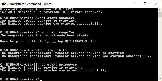

4.Finally, type the following command to start Windows Update Services and hit Enter after each one:
net start wuauserv
net start cryptSvc
net start bits
net start msiserver
Start Windows update services wuauserv cryptSvc bits msiserver

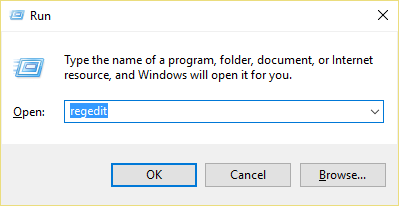

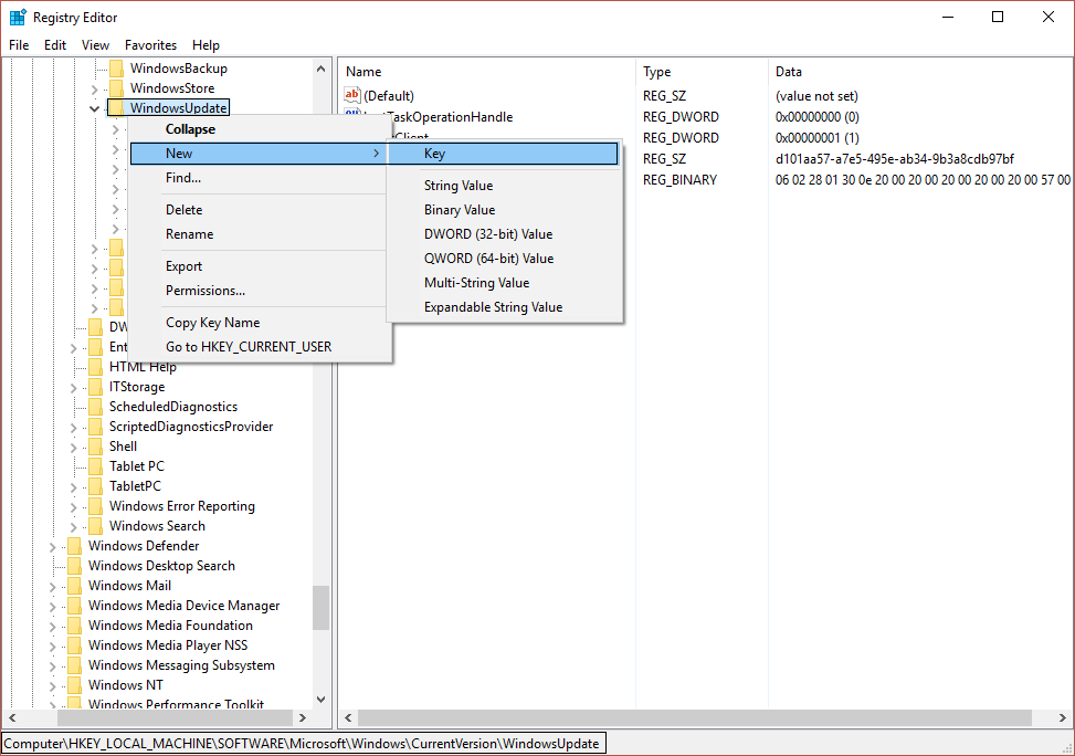

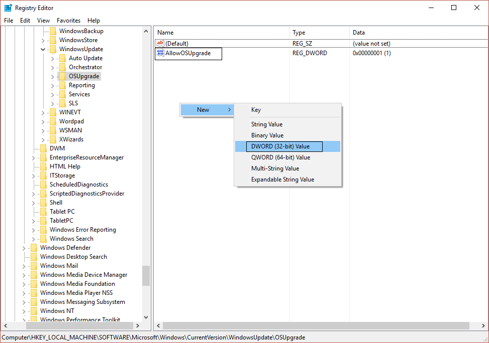

Method 7: Registry Fix
1.Press Windows Key + R then type regedit and hit Enter to open Registry Editor.
Run command regedit
2.Navigate to the following registry key:
Computer\HKEY_LOCAL_MACHINE\SOFTWARE\Microsoft\Windows\CurrentVersion\WindowsUpdate\OSUpgrade
3.If you don’t find the OSUpgrade key then right-click on WindowsUpdate and select New > Key.
4.Name this key as OSUpgrade and hit Enter.
5.Now make sure you have selected OSUpgrade and then in the right window pane right-click anywhere in the empty area and select New > DWORD (32-bit) value.
6.Name this key as AllowOSUpgrade and double click on it to change it’s value to 1.
7.Again try to install the updates or re-run the upgrade process and see if you’re able to Fix The Installation Failed In The First Boot Phase Error.

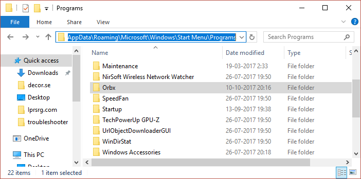

Method 8: Delete a particular file messing with upgrade
1.Navigate to the following directory:
C:\Users\UserName\AppData\Roaming\Microsoft\Windows\Start Menu\Programs\Orbx
Note: In order to see AppData folder you need to check mark show hidden files and folders from Folder Options.
2.Alternatively, you could press Windows Key + R then type %appdata%\Microsoft\Windows\Start Menu\Programs\Orbx and hit Enter to directly open AppData folder.
3.Now under Orbx folder, find a file called Todo , if the file exists make sure to permanently delete it.
4.Reboot your PC and again try the upgrade process.

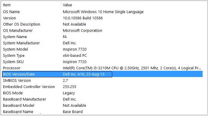

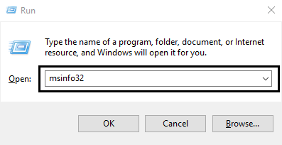

1.The first step is to identify your BIOS version, to do so press Windows Key + R then type “ msinfo32 ” (without quotes) and hit enter to open System Information.
msinfo32
2.Once the System Information window opens locate BIOS Version/Date then note down the manufacturer and BIOS version.

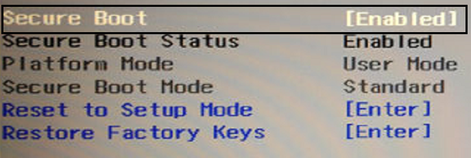

Method 10: Disable Secure Boot
1.Restart your PC.
2.When the system restart Enter the BIOS setup by pressing a key during the bootup sequence.
3.Find the Secure Boot setting, and if possible, set it to Enabled. This option is usually in either the Security tab, the Boot tab, or the Authentication tab.
Disable secure boot and try installing windows updates
#WARNING: After disabling Secure Boot it may be difficult to re-activate Secure Boot without restoring your PC to the factory state.
4.Restart your PC and see if you’re able to Fix The Installation Failed In The First Boot Phase Error.
5.Again Enable the Secure Boot option from BIOS setup.

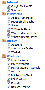

4.Now run CCleaner and in the “Cleaner” section, under the Windows tab, we suggest checking the following selections to be cleaned:
ccleaner cleaner settings
5.Once you’ve made certain the proper points are checked, simply click Run Cleaner, and let CCleaner run its course.

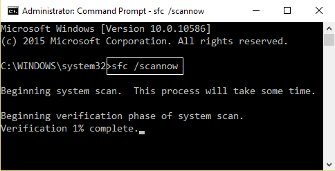

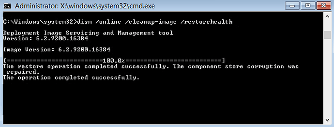

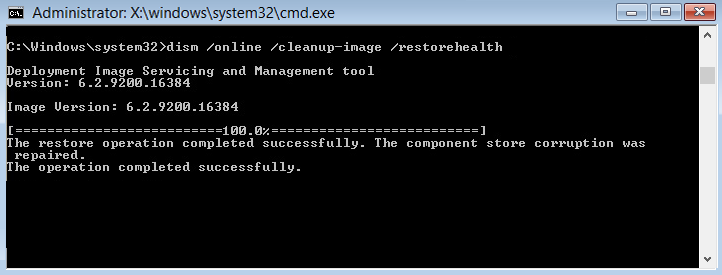

Method 12: Run System File Checker and DISM Tool
1.Press Windows Key + X then click on Command Prompt(Admin).
2.Now type the following in the cmd and hit enter:
Sfc /scannow sfc /scannow /offbootdir=c:\ /offwindir=c:\windows (If above fails then try this one)
SFC scan now command prompt
3.Wait for the above process to finish and once done restart your PC.
4.Again open cmd and type the following command and hit enter after each one:
a) Dism /Online /Cleanup-Image /CheckHealth b) Dism /Online /Cleanup-Image /ScanHealth c) Dism /Online /Cleanup-Image /RestoreHealth
5.Let the DISM command run and wait for it to finish.
  1. If the above command doesn’t work then try on the below:
Dism /Image:C:\offline /Cleanup-Image /RestoreHealth /Source:c:\test\mount\windows Dism /Online /Cleanup-Image /RestoreHealth /Source:c:\test\mount\windows /LimitAccess
Note: Replace the C:\RepairSource\Windows with the location of your repair source (Windows Installation or Recovery Disc).
7.Reboot your PC to save changes.

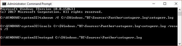

Method 13: Troubleshooting
2.Type the following command into cmd as it (copy and paste it) and hit Enter after each one:
takeown /f C:$Windows.~BT\Sources\Panther\setuperr.log\setuperr.log
icacls C:$Windows.~BT\Sources\Panther\setuperr.log\setuperr.log /reset /T
notepad C:$Windows.~BT\Sources\Panther\setuperr.log
3.Now navigate to the following directory:
Note: You need to check mark “ Show hidden files and folders ” and uncheck “ Hide operating system files ” in Folder Options in order to see the above folder.
4.Double click on the file setuperr.log , in order to open it.
5.The error file will have information like this:
2017-07-07 13:24:01, Error [0x0808fe] MIG Plugin {0b23c863-4410-4153-8733-a60c9b1990fb}: LoadRegFromFile :: OpenFile error (C:$WINDOWS.~BT\Work\MachineIndependent\Working\srcworking\agentmgr\CCSIAgent\005A4BDD\HKLM-E0xxxx04IME.reg) gle=2 2017-07-07 13:24:07, Error SP Error WRITE, 0x00000005 while gathering/applying object: File, C:\Windows\System32\Tasks [avast! Emergency Update]. Will return 0[gle=0x00000005] 2017-07-07 13:24:07, Error MIG Error 5 while applying object C:\Windows\System32\Tasks\avast! Emergency Update. Shell application requested abort[gle=0x00000005] 2017-07-07 13:24:07, Error [0x08097b] MIG Abandoning apply due to error for object: C:\Windows\System32\Tasks\avast! Emergency Update[gle=0x00000005] 2017-07-07 13:24:08, Error Apply failed. Last error: 0x00000000 2017-07-07 13:24:08, Error SP pSPDoOnlineApply: Apply operation failed. Error: 0x0000002C 2017-07-07 13:24:09, Error SP Apply: Migration phase failed. Result: 44 2017-07-07 13:24:09, Error SP Operation failed: OOBE boot apply. Error: 0x8007002C[gle=0x000000b7] 2017-07-07 13:24:09, Error SP Operation execution failed: 13. hr = 0x8007002C[gle=0x000000b7] 2017-07-07 13:24:09, Error SP Operation execution failed.[gle=0x000000b7] 2017-07-07 13:24:09, Error SP CSetupPlatformPrivate::Execute: Failed to deserialize/execute pre-OOBEBoot operations. Error: 0x8007002C[gle=0x000000b7] 2017-07-07 17:24:01, Error [SetupHost.Exe] ReAgentXMLParser::ParseConfigFile (xml file: C:$WINDOWS.~BT\Sources\SafeOS\ReAgent.xml) returning 0X2 2017-07-07 17:24:06, Error SP CInstallDUUpdatesOffline::FindOperation: No info found in section DynamicUpdate.Drivers of file C:$Windows.~BT\Updates\Critical\SetupPlatform.ini[gle=0x00000002] 2017-07-07 17:24:06, Error SP CInstallDUUpdatesOffline::FindOperation: No info found in section DynamicUpdate.GDRs of file C:$Windows.~BT\Updates\Critical\SetupPlatform.ini[gle=0x00000002] 2017-07-07 17:24:06, Error SP CInstallDUUpdatesOffline::FindOperation: No info found in section DynamicUpdate.Langpacks of file C:$Windows.~BT\Updates\Critical\SetupPlatform.ini[gle=0x00000002] 2017-07-07 17:24:06, Error SP CInstallDUUpdatesOffline::FindOperation: No info found in section DynamicUpdate.FeaturesOnDemand of file C:$Windows.~BT\Updates\Critical\SetupPlatform.ini[gle=0x00000002] 2017-07-08 13:30:12, Error SP pSPRemoveUpgradeRegTree: failed to delete reg tree HKLM\SYSTEM\Setup\Upgrade[gle=0x00000005] 2017-07-08 13:30:19, Error [0x080831] MIG CSIAgent: Invalid xml format: FormatException: “id” attribute is mandatory. void __cdecl Mig::CMXEMigrationXml::LoadSupportedComponent(class UnBCL::XmlNode *,int,class Mig::CMXEMigrationXml *,class Mig::CMXEXmlComponent *) 2017-07-08 13:30:21, Error [0x080831] MIG CSIAgent: Invalid xml format: FormatException: Component with display name: Plugin/{39CC25F3-AF21-4C42-854D-0524249F02CE} already loaded __cdecl Mig::CMXEMigrationXml::CMXEMigrationXml(class Mig::CPlatform *,class UnBCL::String *,class UnBCL::XmlDocument *,class UnBCL::String *,class UnBCL::String *) 2017-07-08 13:30:40, Error [0x0808fe] MIG Plugin {65cbf70b-1d78-4cac-8400-9acd65ced94a}: CreateProcess(s) failed. GLE = d 2017-07-08 13:31:32, Error [0x0808fe] MIG Plugin {526D451C-721A-4b97-AD34-DCE5D8CD22C5}: [shmig] Failed to get preferred homegroup with hr=0x80070490 2017-07-08 13:31:32, Error [0x0808fe] MIG Plugin {ee036dc0-f9b7-4d2d-bb94-3dd3102c5804}: BRIDGEMIG: CBrgUnattend::CollectBridgeSettings failed: 0x1, 0 2017-07-08 13:31:38, Error [0x0808fe] MIG Plugin {D12A3141-A1FF-4DAD-BF67-1B664DE1CBD6}: WSLicensing: Failed to read machine binding, hr=0x80070002 2017-07-08 13:31:38, Error [0x0808fe] MIG Plugin {D12A3141-A1FF-4DAD-BF67-1B664DE1CBD6}: WSLicensing: Error reading Server Info hr=0x80070490 2017-07-08 13:31:41, Error CSetupAutomation::Resurrect: File not found: C:$Windows.~BT\Sources\Panther\automation.dat[gle=0x00000002] 2017-07-08 13:31:41, Error SP CSetupPlatform::ResurrectAutomation: Failed to resurrect automation: 0x80070002[gle=0x00000002] 2017-07-08 13:32:03, Error MOUPG CSetupHost::ReportEventW(1618): Result = 0x8024F005 2017-07-08 13:32:03, Error MOUPG SetupHost: Reporting pending reboot event failed: hr = [0x8024F005] 2017-07-08 13:32:03, Error MOUPG CDlpManager::AsyncSerializeDisable(471): Result = 0x80070216
6.Find out what is stopping the install, address it by uninstalling, disabling or updating and retry the installation.
7.In the above file if you will look closely the issue is created by Avast and hence uninstalling it fixed the issue.
