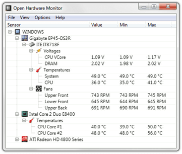

After reading your post I assume you are having hardware issues, that maybe something is overheating and forcing a shutdown. download and run open hardware monitor - if your CPU or any other component is above 90º, there might be an overheating issue.
The Open Hardware Monitor is a free open source software that monitors temperature sensors, fan speeds, voltages, load and clock speeds of a computer.
You can download the software from here Download Open Hardware Monitor 0.8.0 Beta

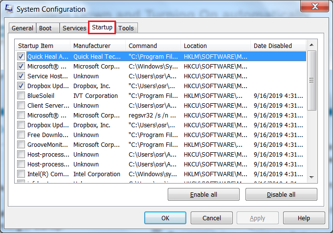

One more option you can use that you run msconfig command and check any unnessary app not running in startup.
