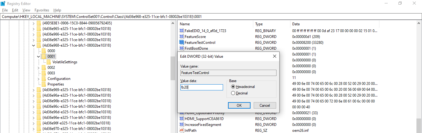

I had this issue to solve it, I had to change the registry setting. Now, finally the screen brightness is back.
Registry path:
HKEY LOCAL MACHINE\SYSTEM\ControlSet001\Control\Class{4d36e968-e325-11ce-bfc1-08002be10318}\0000 (or 0001)
Double-click the item of FeatureTestControl , set the hexadecimal value to " fb20 ", and click OK.
Now restart your PC! Screen brightness is back, no more dim screen.
