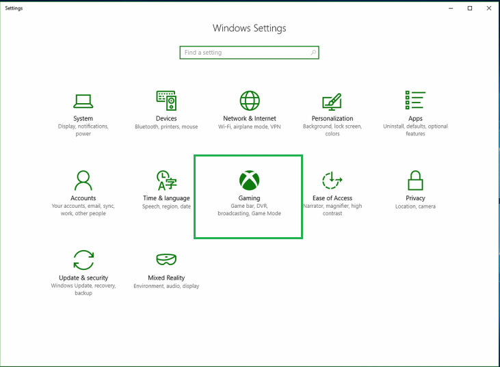

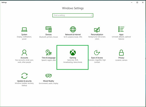

Try to disable/enable the “Game Mode” of Windows
  1. Open the Settings menu by clicking the cogwheel icon in the start menu.
  2. Select the Gaming section of the settings menu.![]
  3. Navigate to the Game Mode section in the side bar.
  4. Click to toggle Game Mode on or off.!
While Game Mode won’t make a huge difference for most games, if you’re prone to heavy background task usage, or you’re using a lower-end system without much overhead for games, Game Mode could be useful.
You can also try to disable everything in the Xbox config; DVR, Xbox overlay, ect.
